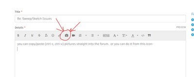

you can copy/paste (ctrl-c, ctrl-v) pictures straight into the forum.  or you can do it using this-
screencasts are another matter.  the insert screencast tool at the bottom of the post is broken/non-functioning most of the time.  been that way as long as I can remember.  from the screencast site you can copy the html for it by clicking embed-
and then back on the forum reply click on the HTML button and paste the code in-
and the screen cast will show up in the body of the post
