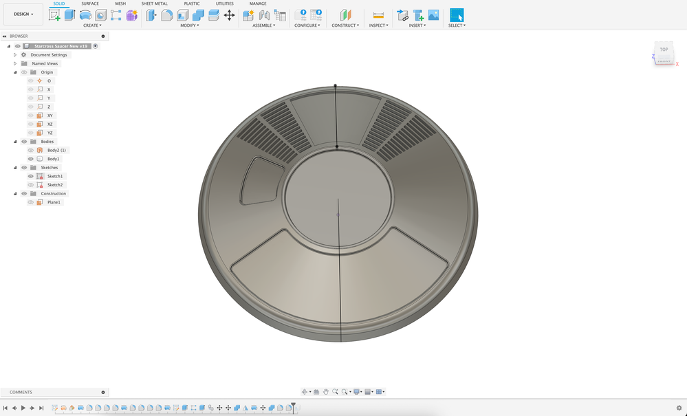

Message 41 of 70
tramtin
I need some clarification on editing the sketch.
When starting to edit it, I still have the old design of the rectangle in place (see picture).
Is it supposed to stay there? When mirroring the long angled line, it gets drawn over the old sketch. The black dots that are visible on your screenshot appear on that line, but the lines don't extend a few mm on either side.

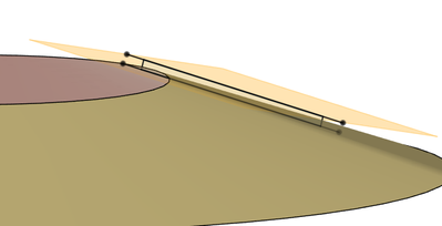

Move the Timeline Marker to just after the Sketch1.
On the Surface tab (we haven't used these Surface tools previously) Revolve the lower line around the axis.
Create a Plane at Angle of 90°to the top line.

Message 43 of 70
tramtin

Start a New Sketch on the angled work plane.
P on the keyboard for Project (geometry)
and select the top SHORTER LINE of the Rectangle. (Because there are two lines overtop of each other it might be difficult to select the correct (shorter) line.  If you hover the mouse over the lines a selection box will appear that will let you select the shorter line from a list.
Hide Sketch1.
Sketch a line to the right of the Projected line in Sketch2.
1. Dimension the length of the line as 30mm.
2. Dimension the vertical height of the line from the top endpoint of the Projected line as 8mm. (You might have to drag the line roughly into position after adding the 30mm dimension).
3. Add a Coincident constraint be select the Vertical line and then Shift select the Midpoint of the Horizontal line.  This will move it over onto the Projected line.
Now double click on the 8mm and change to 0.8mm (we could have done this first, but I wanted it to be clear we are not on the endpoint).
Click on the Projected line and hit x on the keyboard to convert it to Construction linetype (I hid the surface body to make this image a bit more obvious.
Click on the image above to enlarge the view.
Sketch two angled lines approximately as shown and add 12° dimension.
Add a Horizontal line and add Coincident endpoints to the two angled lines...
Now add a Midpoint Constraint between the Horizontal line and the endpoint of the Projected line as shown below.  Everything turns black.
Finish Sketch.

Message 50 of 70
tramtin
Yippee! That worked!
But my goodness, I would have never figured out how to do this. No amount of trial and error clicking would have got me there. I'm in awe, thank you!Screenshot 2025-07-14 at 00.00.54.png

Message 53 of 70
tramtin
Ok that's all done.
