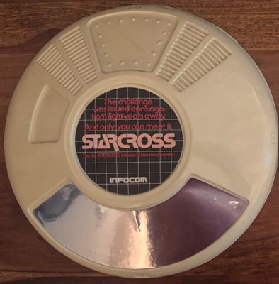

So just a bit more background information on the project:
I'm working on a reproduction of a classic game packaging, the Infocom saucer from Starcross, 1982.
The original (30cm diameter) is made from thermo moulded plastic. I want to print it with a 3D printer, so the feel will be quite different, the design should be as close to the original as possible though.
On the picture of the original saucer you can see that all elements were pushed in from above. They get pushed out on the inside. They all sit on the curved, slanted body of the saucer, so if Project > On Surface would work, that would make this task very easy. Incidentally, if someone has an idea how to do the 4 rows of slots without having to create a design for every slot, that would save a lot of work, as there is 60 of them in total. But first things first, I need to know how to do these indentations first. They are around 3mm deep. I want to find out what's the thinnest wall strength is that I can get away with. I'm hoping for something under 2mm. That means that the indentations will push through the wall (and therefore stick out on the inside).

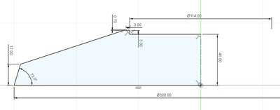

tramtin
Yes, I am ready.
Also attaching the design with the correct measurements of the saucer. It still has a couple of undimensioned lines in there, I still have to learn how do get rid of those. I'm sorry.
One thing to note is that cut outs for the four rows of "slats" have straight slats at the top and the bottom, so the revolve function would give you a rounded design, which is not wanted here. A small detail, but I'm trying to be as faithful to the original as possible. Also, those slats are rectangular in shape (with bevelled edges), rather than round.

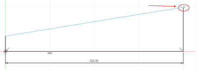

@tramtin
Tip 1. Right click on the vertical line that will be used as axis of revolution and change to Centerline type.
Now we can dimension as diametral dimensions and avoid calculations.
Click on image above to enlarge.
Start a new file.
Create the sketch shown below.
Attach your new progress file here for next step.

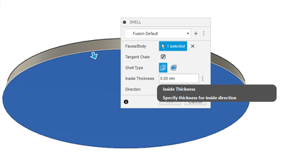

Now Revolve 180° counterclockwise.
Mirror-Join the Body
Turn the body over and select Shell and the bottom face to remove.
Enter your desired Shell Thickness...
Now, drag the Timeline Marker back in history to before the Mirror Feature.
As we progress adding additional features we will go back and forth in history to make sure the Shell feature doesn't fail with any operation that we add.
Attach your progress file here.
