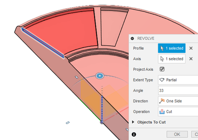

Now Edit Sketch1 and add a 3-Point Rectangle...
Sketch the 3-Point Rectangle snapping two locations on the angled line (be careful not to snap to the midpoint of the original angled line).
Add the 3 dimensions. (You can alter later as desired.)
Zoom in on the image above to enlarge the view.
Drag the Timeline Marker back to before Mirror.
Revolve-Cut the 3-Point Rectangle (I am showing Edit rather than Revolve because I already did it).
Drag the Timeline Marker back to the end and check the Shell.
Drag the Timeline Marker back to before Mirror and add the Fillets. (The order in which you place these Fillets is critical to how they look aesthetically.  I would probably do the short corner lines first,) You can try different orders.
Drag the Timeline Marker back to then end and check the Sell.
Doing the similar features on the top will be a little different sequence of steps.
Attach your progress file here.

Edit Sketch1 and Mirror the angled rectangle about the vertical centerline.
Click on image above to enlarge the view.
Drag the Timeline Marker before the Mirror Body.
Revolve - Cut the mirrored rectangle by 48°about the Z axis.
DO NOT ADD THE FILLETS YET.
Do the usual tests of the Mirror and Shell.

TheCADWhisperer
@tramtin
Now do a Revolve Join by 36°
Now do a Revolve Cut by 33°.  (We can adjust all of these dimensions later as desired.)
Do another Revolve Join by 21°
Now do another Revolve - Cut by 18°
Hide Sketch1 and test the Mirror and Shell to make sure they don't fail.
You can add the fillets to the center slot, but not to the two (four) end slots yet.
You can Edit Feature and adjust the angles as needed. (I don't have the part in hand and calipers to check.)
