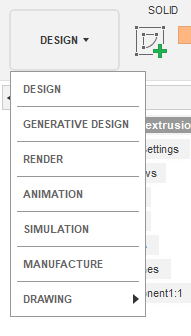

How do you get into "THE PATCH" mode.
The options I see are:
"Design, Generative Design, Render, Animation, Simulation, Manufacture, Drawing"
