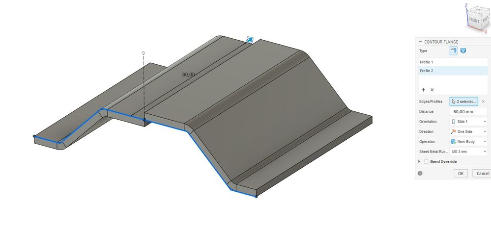

Why it is behaving like this. It suppose (and it used to) to make one continuous sheet metal piece bent 5 times.  Now it treats every polyline se a separate body?????
Anyway to make it behave like it used to? Treating all the connected polylines as single piece and applying bends at connections as well. fusion.jpg

It is even worse.  It creates a single body sheet metal part that it then fails to create flat pattern for,....  😵

There is obviously an error in the sketch in the connection of the lines at the origin, but it could not be corrected in the sketch.
Therefore, I created a new sketch that produces the expected result.

I get that. But up until now you did not have to do it in one go. Lines were automatically merged to one polyline (so to speak) you could start in the center and then added line. I do it like this all the time because a lot of times i change / add sheet metal profiles afterward.  This effectively prevents changing base sketch line once you close the tool. It should not do that. This severely limits what this tool can do.......

In some tests, I noticed that the phenomenon only occurs when the profile starts at the origin and another element is added there.
If you create the primary profile without binding it to the origin, you can add elements and, if necessary, subsequently bind the docking position to the origin using a constraint.

I took a quick look at this design. I have seen the behavior before. It seems to be related to the open profile recognition. Creating a surface from the same sketch may lead to the two separate surface body also. Somehow the horizontal line (150mm) is constrained to a point (probably a corrupted projected origin?), not to the end point of the vertical line. As a result, it leads to a split. If I delete both the horizontal line and the vertical line, and recreate them, the profile will be properly recognized.
I suspect this is a corruption case. If we can reproduce it from scratch, it will be very helpful to finding a fix.

I deleted the Coincident Constraints and moved the lines away from the Origin. (I did not delete the lines.)
I then applied a single coincident and left them away from the Origin, observed the same unexpected behavior.
Edit: I then tried deleting EITHER the vertical line or the horizontal and replacing.  Replacing EITHER of these lines returned to expected behavior.

I am sorry I don't know why it has not been resolved. I thought it was. Maybe I misunderstood the issue to begin with. Are you trying to merge the new Flange to the existing one? The panel shows it is creating a new body.
