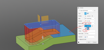

Hey guys, I’m wondering how I would go about cutting a profile down into an uneven surface of a solid but for it to be the same depth from the surfaces?
I want this profile to be cut into the part 8mm from the different surfaces uniformly

Surface > Create Offset, Set Offset At 8 mm, selecting all those top faces
Extrude to Object, Select Surface Body in the Browser.
Might help.....

you can do it with "extrude to", setting the offset to the depth you want-
