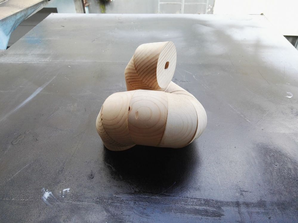

I would like to repeat some basic tasks (like copying, translating and rotating at the same time) for a couple of dozen times. I'm building organic forms and want to see how they evolve by using very simple moves. So is there a simple way in Fusion to repeat such basic commands over and over again? I have attached a real model and a Fusion File to show what i'm looking for. IMG_20170913_171713.jpg

If this picture is what you're trying to achieve, then you can simply use a sweep in the sculpt workspace and apply crease every fixed number of edges
If this is what you want, I'll make you a screencast to make things clearer

I'm not sure but I'll check that out. Thanks. Like I said, I want a easy way to simulate what happens if you take a basic shape with an angle and do the same (Copy/Move/Align) over and over again. To see for example how a certain angle  changes the overall geometry.

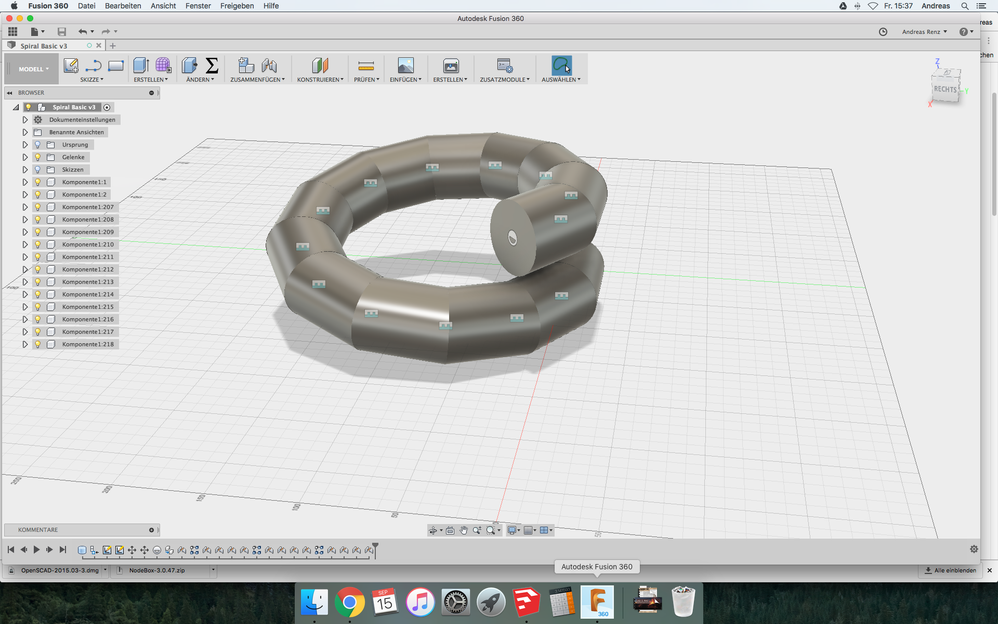

@TrippyLighting is right, procedural geometries isn't the type of thing fusion can do (for now?).  But if your going to stay with fusion, one approach would be to use components with joints.
-make the component
-place a joint origin in the component
-make copies
-use joints to put them together.
once done, you just have to make one change to the joint origin, and the way it all goes to gether will change
here are 2 screen shoots of the design, from the same perspective (based on the screen shot of your original)  the only difference is I went in and changed the rotation angle of the joint origin in the original component from 0 deg to 45 deg (just have to make the change in one place)

This work more or less. Thanks. It is still tiresome because there is no way to make multiple copies of component including the joint. So I really have to link every single component. But this works for the moment.Bildschirmfoto 2017-09-15 um 15.37.49.png

laughingcreek
You can take all those you've jointed together, drop them into another component so you have an assembly.  copy and paste the assembly, and join the assemblies.  still tedious, but you can grow it faster.
