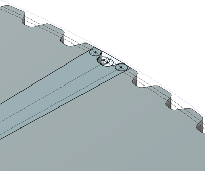

No reason to import spur gears, there's a built-in script for that.  If you still want to import an stl gear, then just import one tooth(and valley) and circular pattern it.
Here's a screenshot of a 120 tooth timing belt pulley showing how it was modeled.
Involute gears are a little harder to model directly, but it's easy to convert a single tooth to a spline from a section of the stl.  The stl can be split in Fusion 360, Meshmixer, or Blender to get the tooth.
ETFrench
