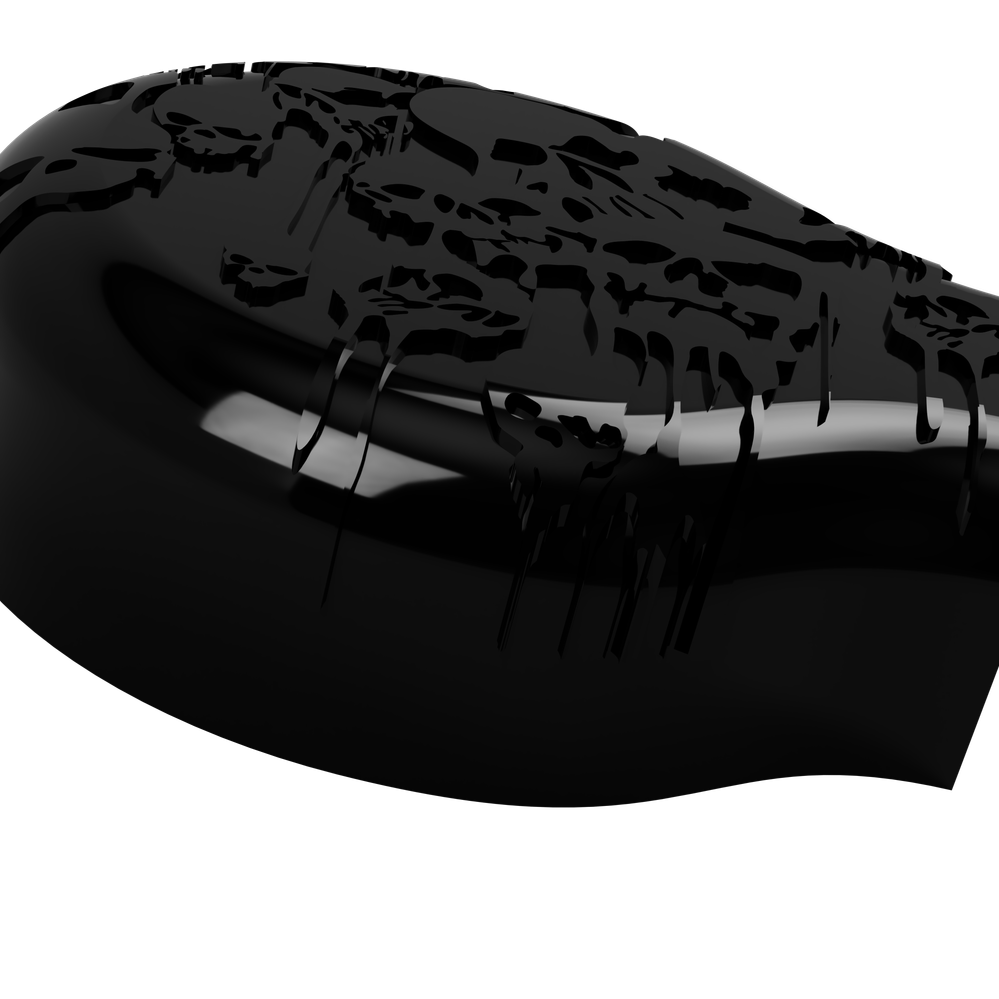

I have projected my sketch to the surface but only the flat top areas of the sketch will show profile for extrusion or embossing. I realize that it is probably a break in the sketch but I cant find them. HELP

Emboss has recently been Turbo-charged but your geometry if I understand may not be possible still.
I gather you want to have the emboss on more than the planar face?
Message 6 of 14
old-hippie
Yes that is correct. I would like it to wrap around the air cover. Is there a way to do that maybe in multiple steps?

Warmingup1953
What about a slight fudge?
Message 11 of 14
old-hippie
yes that works. How do I get there? I know that I am doing something wrong or missing a step
Message 12 of 14
Warmingup1953
Not very elegantly, unfortunately.
The top planar surface embosses fine:
Then I did a simple extrude new body:
then sweep cut that body roughly to shape ...it looks more like dripping icing than an emboss would but in this case it may be within appropriate design outcome:
As I said crudely done but offered as is!
Message 13 of 14
old-hippie
Not exactly the effect I was looking for and it still needs some tweaking  but it will work until I can figure it out. Art can be frustrating. When I do figure it out I will post on the process for anyone else that want's it. I do apricate ALL the replies I have gotten and thank you all.
