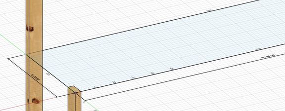

Here is where I start
I start here and select sketch selecting the top plain on the object closest to meI start here and select sketch selecting the top plain on the object closest to me
I sketch using the top of the object closest to me as the plain, defining length and width
I then parametrically define the length and width of my sketchI then parametrically define the length and width of my sketch

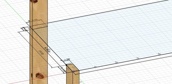

I define the corners in prep for the extrusion sans the corners
I then define the cornersI then define the corners

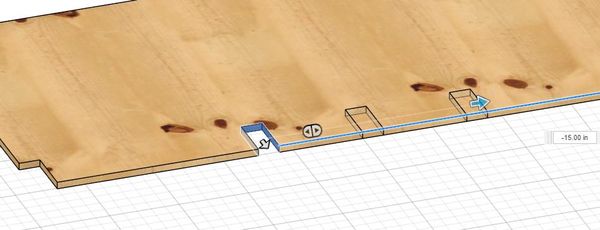

when I try to select the corner as a feature, it ends up wanting to select the whole object.
When I try to select the feature being the corner, it selects the whole object.When I try to select the feature being the corner, it selects the whole object.
If I try to select the faces, there are only two faces so not enough to define the whole cutout
If I try to select it by faces, there are only two faces and that is not enough to define the cutoutIf I try to select it by faces, there are only two faces and that is not enough to define the cutout
I can easily do it from the middle of the edge, where I am able to select three faces, or even as a feature, I am just not able to do it from the corner.
If I put the notch in the middle of the edge where I can define 3 faces...If I put the notch in the middle of the edge where I can define 3 faces...I can use the rectangular pattern tool with no issuesI can use the rectangular pattern tool with no issues
