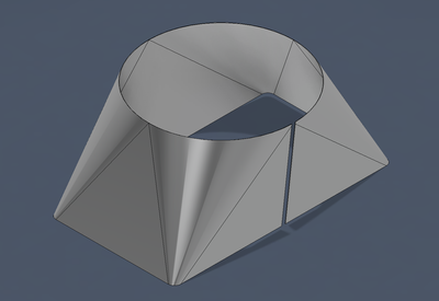

I am using a lofted flange (sheetmetal) to create a rectangle to round transition.  I want to extend the round up a by 10mm to give some extra material which will lap underneath the round spigot that will be spot welded on top (the lap then gets swaged).
I can't figure how to do this.  I have tried all sorts, including creating a solid spigot (same material thickness) and trying to use the edge of this cylinder for the round profile of the lofted flange.  AI said this was the way ‌‌ but it won't let me select this edge for the lofted flange.

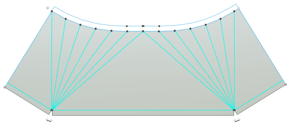

The easiest solution I have worked out for a one off is to modify the flat pattern using offset like below.  I had problems with this too, but that is another story.  However I am trying to setup a template with parameters so all I need to change is the rectangle size, round diameter, and the height of the transition.
2026-06-10 10_35_51-Rectangle to round transitions v3_ - Autodesk Fusion Personal (Not for Commercia.png
I could always simply increase the height by say 10 mm, and then reduce the diameter of the round.  This would be more simple to calculate accurately if if was a square to round.  But because the rectangle with short sides and long sides creates different angles, this is not so simple to work out.  I did this on the last one, but got it slightly wrong, so the diameter of the round was too big.  But ideally I would like to automate adding the extra using parameters if possible.

kacper.suchomski
Hi
Look at this:
(view in My Videos)
Kacper Suchomski

andrewsownemailPPGVB
Thank you Kacper!  This looks good, and appears to work well.  I will go with this and let you know how it comes out this time.
The only thing that breaks the parametric side of it, is when I changed the circle diameter, I need to redraw the ellipse. on the projected round shape.  And then reselect the ellipse as the top profile of the loft.  Re-creating the loft then breaks the references for the flanges at the bottom of the rectangle.
Hopefully I am on the right track to working around that with this?...
To create a parametric ellipse that references projected geometry, you must use the Project tool with links enabled, capture the dimensions in the Parameters dialog, and build an ellipse driven by sketch constraints rather than just drawing it freely.

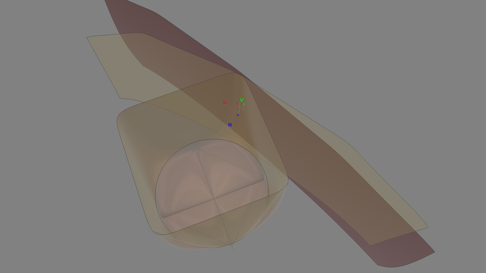

File attached.  It wouldn't upload for some reason the other day/
I have found that if I change the size of the rectangle or the round (which therefore changes the shape of the ellipse):
The projected shape created from the top of the temporary surface loft body adjusts accordingly, but I have to redraw the ellipse.
As mentioned, a new ellipse means that a new loft profile needs to be selected, and then new flanges on the bottom, and also recreate the 20mm extrude for the lap to join each half.
Hopefully, I can eliminate having to redo these steps after a change in size.

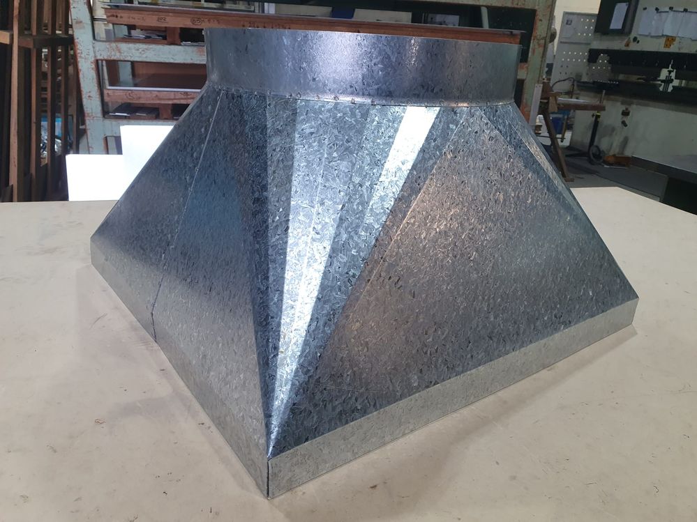

Sorry, I only found out the result end of last week after we completed it.   Kacper's solution worked a treat.  I scored a 10 mm line down from the top and the edge of our round spigot matched it near enough perfectly!  So thank you again Kacper.
On a side note, I never realised before that all the bends are slightly different angles on a rectangle to round transition.  It takes a bit of time doing all the bends at different angles.  Could probably get away with doing them all the same angle on a lighter piece but this was in .95 mm galv so we did it properly.

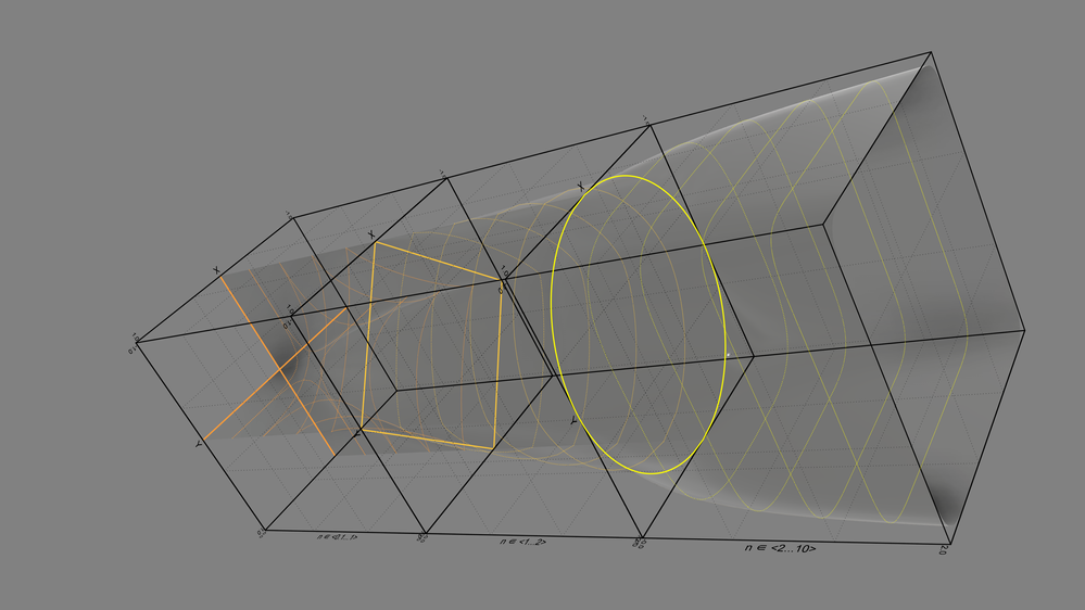

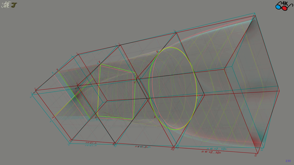

MichaelT_123
Hi Mr AndrewSowneMailPPGVB,
... for the sake of curiosity, I ran "flattening" on the squircle object as in:
https://forums.autodesk.com/t5/fusion-design-validate-document/need-advice-to-sketch-squircle/m-p/11...
The basic outcomes are in the attached file.
The "flattenings" were applied to two bodies: one representing a "progressive squircle" (n∈<2,10>)
and the other a loft between a circular base and a "squarish" square with parameter n=10.
