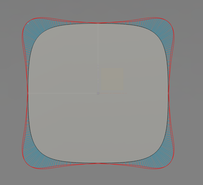

travis.designer.vn
I also try use Conic, but not sure Is it right or wrong?
Message 5 of 8
TrippyLighting
Either one is a good approximation.
In industrial design 3-degree and 5-degree control point splines and resulting surfaces are the prevalent design tools.
This image and the attached model include both versions.
Message 6 of 8
TrippyLighting
I have to revise my judgement. I downloaded the .svg from Wikipedia and tried to match the curvature with both, the conic curve and the 5-degree control point spline. The 5-degree control point spline clearly wins!

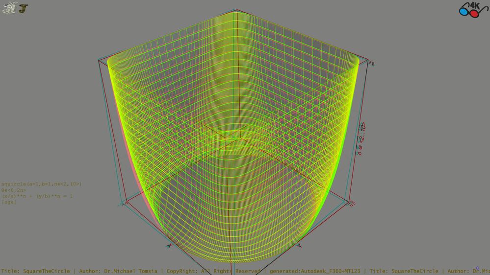

Squircle is undoubtedly a fascinating topological object ... and not trivial, both mathematically and philosophically.
Here is my effort to harness it in F360 (extended) environment.
The file Squircle_Fusculator.f3d contains squircylinder. A planar xy intersection of it represents a squircircle curve:
(x/a)**n+(y/b)**n = 1
… so, in essence, it can be used as a respective squircle curve calculator. Note… n does not need to be a natural number! Just … change the model’s user parameter n, and the curve will … recalculate itself at the front of your eyes. The fusculator is a little wired… but it is what it is! Anyway, there are far more strange phenomena in F360 😉.
The file can be freely used in your and others' projects without restrictions.

Message 8 of 8
MichaelT_123
Hi Fellows,
As the Squircle object is fascinating, I have decided to update the domain of its rendering. So, the domain was extended from <2,10> to <0.1,10>.
One might ask why not to <0,∞>?
These are the reasons:
  • The solution at 0 does not exist as based on the GAAP (Generally Accepted Algebra Principles) limit of function x**x when x→0 does not exist. It plays with intuition, as by looking at the rendering of the function, a cross looks like a sensible solution!? I could not manage to render such topology at 0 and also in the region (0,0.1> though, as the F360 was getting … crazy!
  • Calculations of (x/a)**n+(y/b)**n = 1 in the region (0,0.1> encounter significant numerical challenges, even when done with extended precision.
  • Why not to go to ? … Well, perhaps this is obvious! It is the place where the circle subscribed square is! … and squaring the circle is obligatory, not allowed! Contrary to that, the circle inscribed square is perfectly legal (n=1).
Please find updated files. Additional conditions are as in my previous post.
