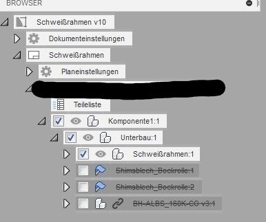

with #1 I still have my problems. Dont even know If I understood correctly, but let me show you my problem.
In this picutre I isolated "Schweißrahmen" by rightclicking -> supress everything except
After that I did my work on the different sheets and then added the next components into "Unterbau".
Then it looks like this:
and destroys more or less my whole drawing.

Pramod.kadam
Hi @mbl_busse ,
I checked this case again for sub-level assemblies. This works fine for first level assembly but for sub-assemblies at different level, the newly added component gets added in un-suppressed state by default.
We will look into this behaviour.
