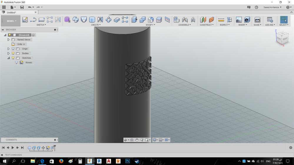

SaeedHamza
Here are some pictures for a mosaic projected on a cylinder, check them out
regards
