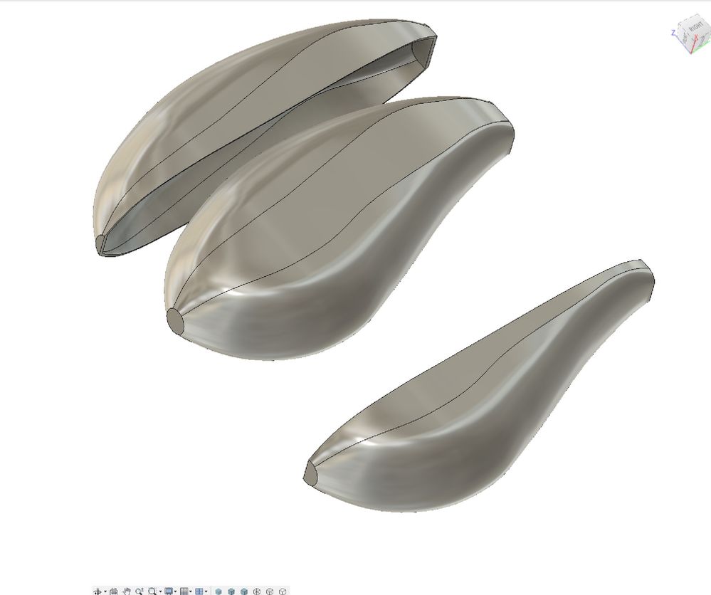

I am attempting to make a stencil for the crankbait. I attempted to thicken it with the push pull tool to .2". I then intended to use "combine" then select crankbait (1) and as the tool select crankbait (1) (1) and set to cut. I was hoping to be left with what would basically be a .2" thick empty shell that would fit around the crankbait. Of course at some point I will have to split the body to actually open and close the stencil. Every time I attempt to use "push pull" and enter a value, I receive an error message. I have tried to remove fillets that I used to have at the front and back and have tried many values but I cant seem to figure this out. I have had no formal training on any Autodesk products but have had some experience several years ago and am trying to relearn what I knew. Any help would be appreciated. Thanks

Screenshot 2023-03-04 122734.jpgCan you use Scale?Screenshot 2023-03-04 122430.jpg

I appears from what you did that I can use the scale command. I did a section analysis then scaled entities set to uniform. I then used combine, cut, make new component and keep tool. I am having trouble removing the tool body after the operation so the scaled body is not coming out hallow. Thanks for everyone's time. I promise this is the last time I will bother you all with this one.

Here's my Quick go...I Constructed some planes so as to get the Centre point of scaling but I think I recall this was unnecessary.

thank you I really appreciate your sticking with me on this one. I understand now what I was missing and why it wouldnt hallow out after scaling and combining. It was detached I just didnt do the 2 finally move commands that you did to move the body away from the combine tool. Thanks, I learned a lot.
