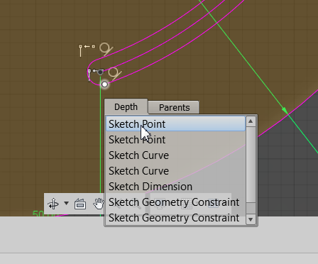

Someone in the CAM forum was having some problems with some circular slots. I traced it back to a circular pattern, in the example below I have one slot drawn, closed and constrained. The copies are all open. Also shows a problem with the constraint highlighting as as far as I can tell the first slot is fully constrained. File attached without pattern.

Hi @HughesTooling.  Yep, that's a bug.  Thanks for bringing it to our attention.
The problem is not in the pattern per se, it's in the slot that is the source.  This geometry does not have points properly "merged".  There are two points on top of each other here:
I'm going to guess here that the end point arcs of the slot were created by Center Point Arc.  This command has a bug where this point merging does not work correctly.  Even though you have added coincident constraints, the points are still not merged and they should be.  We are in the middle of fixing this bug.
However, even without that bug fix, this should work, I believe.  I will file that bug and get it looked at.
Also, Fusion really needs an "arc slot", or even a general "slot from curve", so you can have a slot from a spline.
There is a workaround, although it is ugly.  Here is a screencast:
