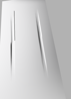

Hello
I need help about a product that i've create.
As you can see when i switch in realistic view the hollow is not smooth.

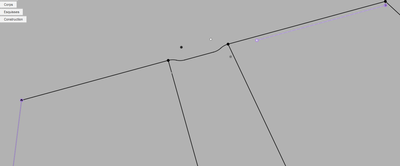

Here you can see the sketch of the hollow.
I create this product in 4 parts but that's not working perfectly.
Can you help me to solve my problem?
Thank you

This was a difficult one, I tried using Patches but that was worse. It may be that you just need to define more rails.
Screencasts function isn't working, here's the link
https://autode.sk/3uVq4zA

Hey, thanks for your answer.
But is not realy that. As you can see on the last rectangular surface after the hollow there are a allowance.
The last surface need to be totally flat.
Message 8 of 8
mango.freund
hello @Anonymous  Of course I've seen that, but even when I make two individual areas and staple them together, this "ghostly" appears. - I did my best.
ps: more rails lead to even more bumps. greetings mango
