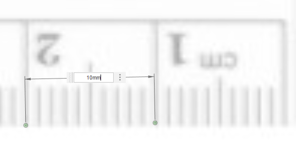

Here is more detail about that Canvas workflow.
Find an image of a ruler, insert it as a Canvas
Find it in the browser and right click on it, pick calibrate:
Pick two points on the image (zoom in close)
I usually do this a couple times to be sure, and it helps to have a high def image.
Save this file by itself so you can insert it. Here it is, inserted as a component (so you can move it). The bolt is 4mm diameter.
