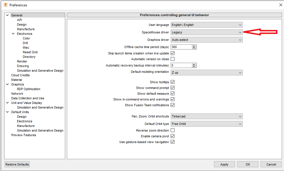

There is an update to Fusion 360 to address the following issues for customers using Windows:
  • Support for older 3Dconnexion devices
  • 3Dconnexion pan and zoom behavior in Sketch mode
The update includes a new preference to use the legacy 3Dconnexion drivers for the experience of the previous integration between Fusion and 3Dconnexion devices. If you have an older device, it should be supported by the Legacy driver setting in Fusion.
Note: This will also remove the newest features like constrained orbit, and advanced button customization features, but only temporarily. We are currently working with 3Dconnexion on a solution for the sketch pan/zoom behavior that is intended to provide both the latest functionality as well as options for sketch behavior.
To get the latest build, 2.0.11894:
  1. Restart Fusion 360
  2. Watch the Job Status indicator
  3. When complete, click Restart Fusion
To get the Legacy driver option:
  1. Open Preferences
  2. Click the dropdown next to SpaceMouse driver
  3. Select Legacy
  4. When prompted, restart Fusion
Phil Eichmiller
Software Engineer
Quality Assurance
Autodesk, Inc.
Message 15 of 35
