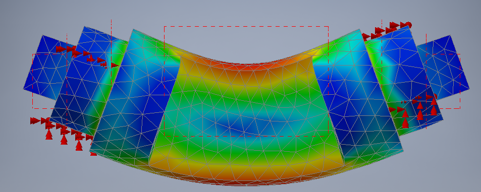

Hello I was running some tests with a toy problem to get a grasp of what can be done with rigid body connectors. This is a simplified problem of some more complex models that I've done.
The idea is to calculate this model:toy problem model.png
This can be done easily simulating every piece. In the model the white and green bodies can rotate around the X axis. While this can be done, in some cases there is no information of the supports other than they should be much stiffler than the beam. The results should look something like:toy problem results.png

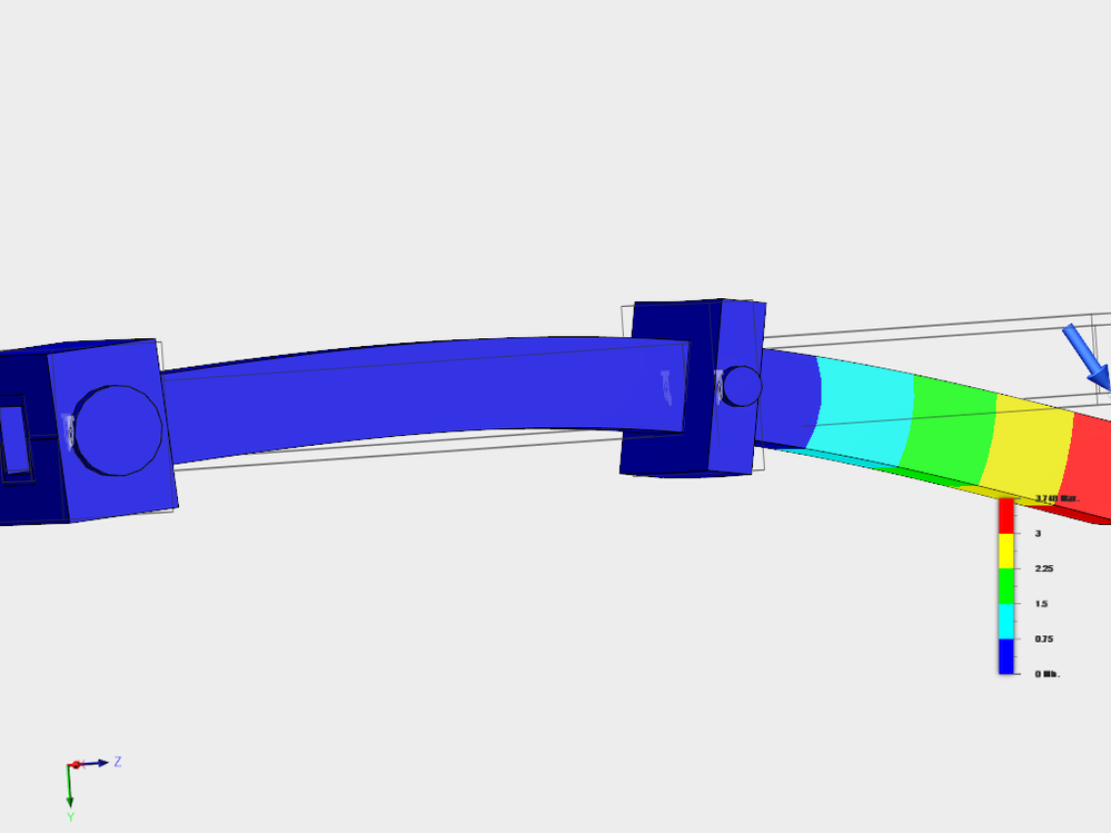

 I have tried to do the same using rigid body connectors. For that I set two small bodies that I restrict completely. I connected a corner of those bodies to the surfaces that were in contact with the supports. I have tried conecting just the appropiated degrees of freedom without success. Therefore, I tried to run the same model with all restrictions and all connected degrees of freedom. It seems to me that rotational degrees are not connected or I'm missing something.
Here it is the model and the results. In this case it shows a rigid body rotation around X:toy problem model 2 detail.png

Alberto,
The rigid connectors are working as designed and the issue is with the solid elements.  Review the attached model for my changes in the set up.  This will give you some ideas on how to use rigid connectors to simplify the model.  What you will notice is that I created two rigid connectors per pivot point.  The anchor points of the rigid connectors should be defined along the axis of rotation you are expecting.  You were almost there because you added the small blocks to the model to help define that axis of rotation.  Also, be sure to notice what I selected as the Dependent Entities as you can only define a surface/edge/vertex one time for all instances of Rigid Body Connectors.
The reason you are getting the twist is that the solid element nodes have an unrestricted rotational degree of freedom.  To see this in a simpler way, create a block and apply a fixed BC to a vertex.  what you will see is that the model is only partially fixed.  This should also answer why the DOF View, for your model, is showing as fully constrained when it really has the ability to rotate.

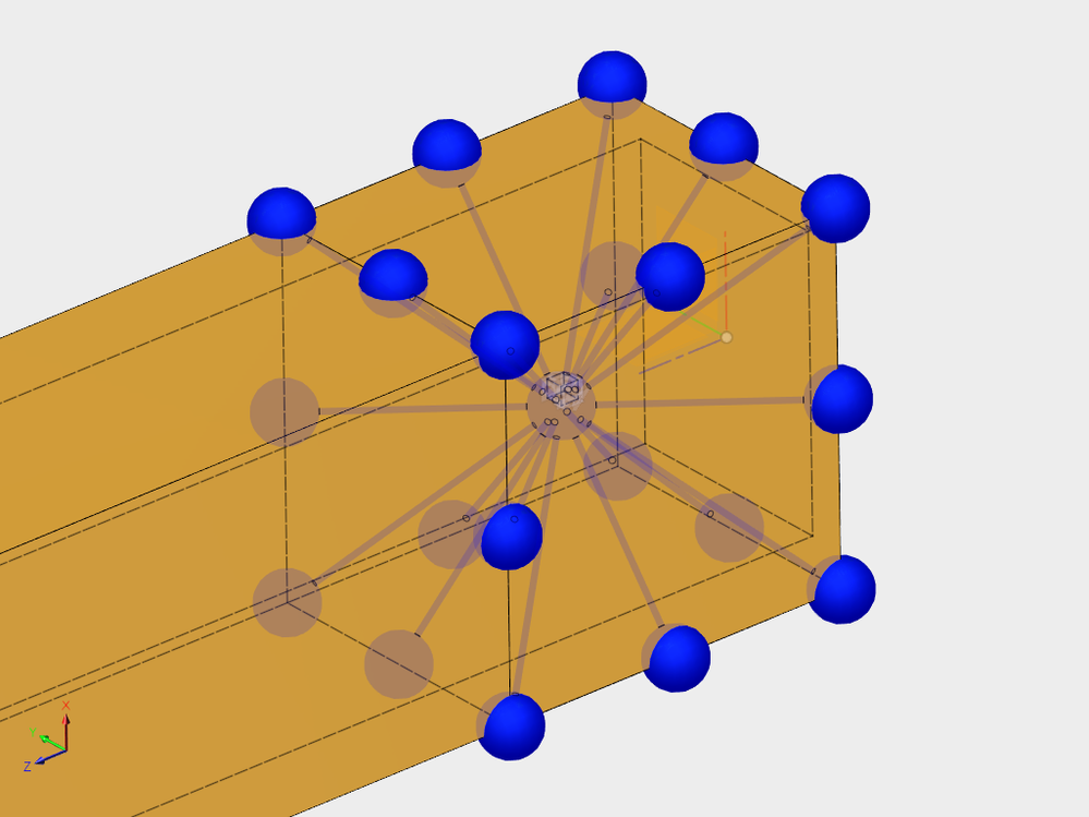

David-Truyens
Hi @Anonymous, @AndrewSears,
I would like to popup this thread. The rigid connector is very important to correctly define the DOF's in an analysis. The most common mistake I've seen made in all my years of FEA teaching is the pin constraint. If you do it using a pin you'll get something like this:
Instead a real pin would look something like this:
The usual way to do that would be using a rigid connector and a constraint to the central node of the connector.
Now you have to do very crazy stuff (create a rigid connector to a vertex of a solid???) to try to get something done, but in the end it doesn't even do the job.
Even better would be a button to create a real pin constraint in one go (and do the trick with the rigid body in the background).
