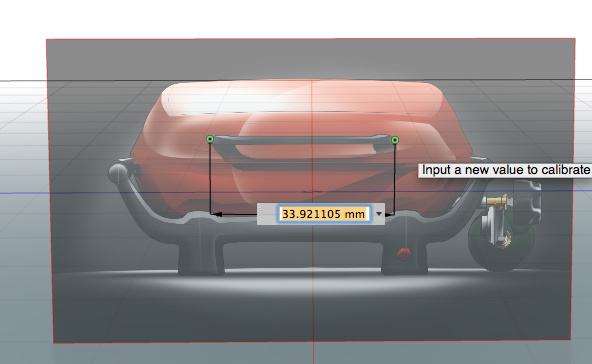

Now go to the browser and click on the Canvases folder and the right click on the image file you imported above.
Select Calibrate from the drop down list.
The Calibrate tool allows you to select two points on the image and set the real distance to scale the image to.
On the canvas select two points and enter the desired distance and hit enter.  The canvase will scale accordingly.
For my example I chose the lenght of the handle for the BBQ lid and set it to 12 in.
