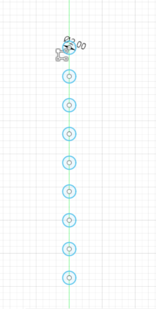

Not sure if this is related to the changes to the personal license but I have just drawn a sketch, patterned some circles, saved the sketch and then went to extrude all of the circles but it will only allow me to select the first circle.

Yes "Show Profile" is checked. I can see them in the extrude command, just can't select them.

When you patterned the hole, you select the center point "only" for your pattern.  Go back and edit the pattern and select the circle also.  I would recommend only Extruding one hole and pattern in the model instead.  Much more efficient.

I only see one circle in that sketch.  It looks like somehow only the center points were patterned.

You have another problem which is preventing you from creating the extruded holes.  The bodies are only surfaces in your model.  This will give your issues.  Is there a reason you are using surfaces?
