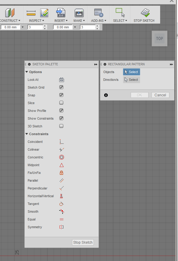

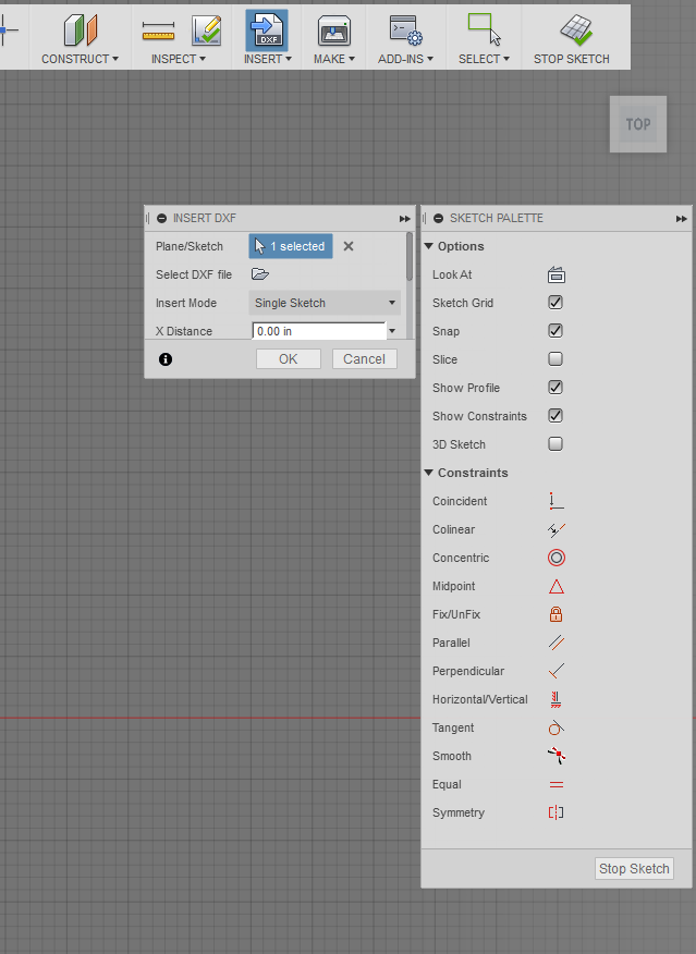

The dialogs tend to work better if they are docked to the side of the screen. In the model workspace they work better if they're docked like this.
Dock the dialog on the right first then dock the Sketch palette to it.

HughesTooling
I see the same problems if I dock the dialog to the left of the screen. I complained about similar problems in the model workspace a while a go and it was pointed out the dialog will resize if it's docked to the right side of the screen. Don't know when it will get fixed but it looks like resizing of undocked works better than it used to so they are working on it.
They still don't work well if you dock them like this.
