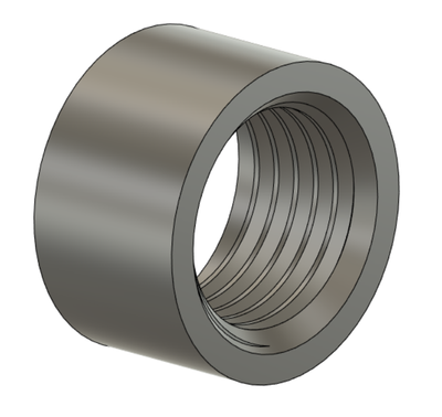

This works! Thanks, goldschmidtb Sometimes it really pays to read through all the posts on a thread - someone will offer an answer and simply move on. Here's some screen shots. This should work for the time being for anyone needing NPT threads. Use the align tool to center with your hole and combine (cut) to create your threads. These are modeled and will print.
(In case this solution is separated - use the insert function to import a McMaster-Carr part, use it to create your threads)
All the best, Don

Hey everybody. I needed NPT threads on a part I'm about to 3D print. I came here expecting a solution but none were presented yet, so I thought I'd let you know how I made it happen.
All I did was go to McMaster and download a CAD file of a part with the threads I needed (in this case I downloaded a 3/8 x 1/4 NPT straight reducer). Then I just started removing features from the reducer until it was left with a threaded blank:
I made a hole in my main component where I needed these threads, alligned the threads with the hole, and combined the two geometries. Now I have the NPT threads I need and I can get to 3D printing.
It's a little unorthodox, but it absolutely works. Who wants to sit through a tutorial on manually cutting tapered NPT threads?
