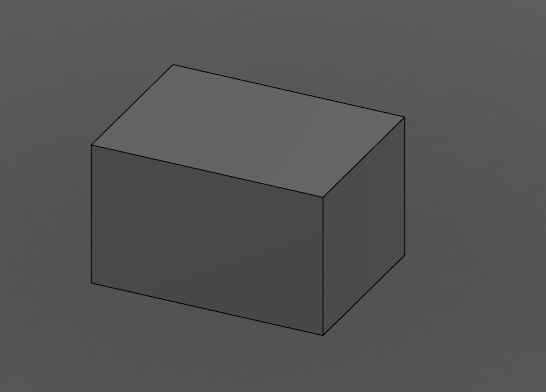

When you say "rectangle", do you mean a sketch rectangle, like this:
Or a 3D solid block, like this:
Either should work OK, but they are different operations.  Would it be possible to post a screencast or video of your workflow in this case?
