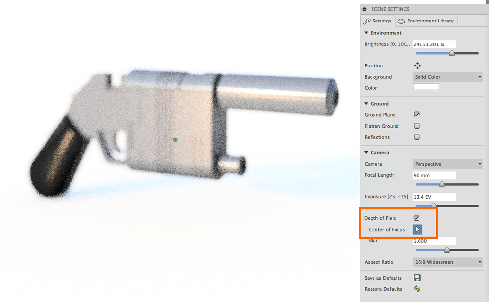

Message 6 of 8
colin.smith
Hi @Anonymous
Can you show a screenshot of what you are seeing?  The blurriness might be because you have depth of Field turned on but you haven't clicked on part of the model to be the focal point.

Message 7 of 8
colin.smith
Hi @Anonymous
