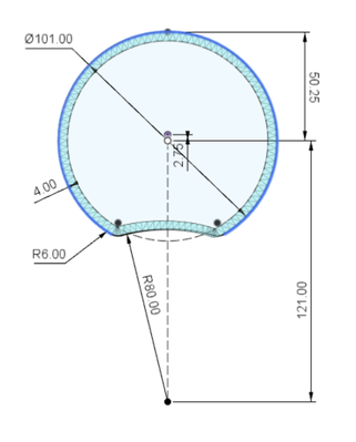

Anyone else has the same issue, not being able to measure a mesh ?
I don't get any results and it puzzles me....

I open this 3mf file , but I can't measure anything. it works though when I create the mesh in Fusion 360
PS: had to zip the 3mf file, wouldn't let me upload it otherwise

that is not true , you can measure mesh .... look at this:
this is a mesh and measure works here

I don't have any problem measuring your mesh. Not sure if I have the latest version of Fusion though, haven't shutdown for a few days.

@stiller.design  Yes, something odd about the mesh in your file, I can't get measurements off the mesh either.
Have you got the original mesh file? Can you share it here?
Thanks Mark

In some tests I found that the measurement function only works if only the STL format was used for the imports and exports.*.
But, wherever, 3mf was involved, the (defined) measurement is no longer possible.
For this purpose, the file name is not taken over when importing 3MF (in contrast to STL).
* In later attempts, however, it no longer worked even with "pure" STL files.
