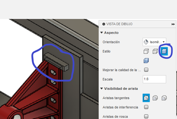

dbeltrang
Still having this problem. I tried the duplicate trick and it does not work for me. But today I realized something new. It depends on the style. So chosing "sombreado", closing, chosing "aristas", closing worked for me.
