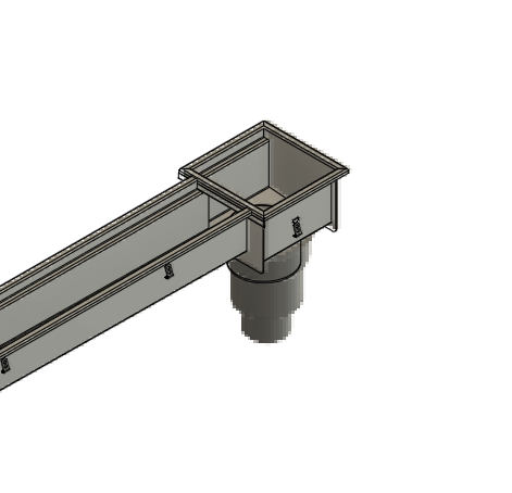

I have an urgent task of creating "as-built" drawings based on my earlier drawings. I have the following problem:
I have some new components in the assembly that were added later than when the drawing was originally created from the assembly. (New components as well as new sub-components of existing components).
After updating the drawing the added parts should be shown, but to my surprise this is not the case (either shading is shown but no contours, or nothing at all.)
Also it is the same for new features of existing components.
I don't know what is going on, doing all the drawings again from scratch instead of just updating existing ones is not an option.
Please share if you have experienced this or if you have any solution or ideas at least.

@ClintBrown3D
Also seeing this.  Newly added components only showing in ghosted form(no outline semi transparent) on shaded views. Without shading nothing is shown.

liang_chen
Thanks for sharing the dataset. We can reproduce this case, and it has been tracked for further investigation.
Currently, the workaround is to select all new components in drawing browser and click 'suppress all except selected', then select top assembly in drawing browser and click 'unsuppress all components'.
Please check whether the components will be loaded successfully.
