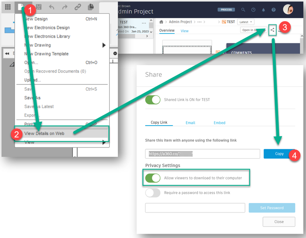

Please can you share a downloadable link to the drawings with me? Or if it is sensitive, feel free to send it directly to me Clint. Brown {a} Autodesk.com

Please share a downloadable link to your drawing, so that I can ask the team to investigate this, or if it is sensitive, feel free to send it directly to me Clint. Brown {a} Autodesk.com

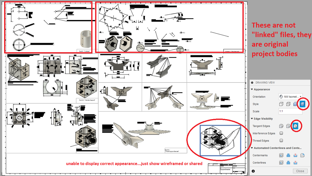

So first i broke the link in the Fusion 360 main project, to the f3d files i had added.
When i did this, the drawings updated with messages that all my relations inside , related to those specific objects, were no longer valid, since they essentially were referring to the old , linked objects, although visible, i could not associate the dimensions and such. So i had to delete the base views and projected views i had made, letting the text remain as identification marks.
Afterwards, i just remade the base-views , after i had updated the 2D from the project with updates.
Because the updates i now would get from the project would be with the non-linked objects.
I started redrawing now, using the UNLINKED objects, and so far, no glitches like before.
So it seems the main reason for the glitches is because i used linked objects into my 2D drawing.
I see from the screenshots in this post that other people also use linked objects/components and bodies, and it would be interesting to see, if they broke those links, and remade the 2D like i explained above, if they also stopped getting broken representations in the 2D view.
The suggestions to suppress/unsuppress was unsuccessful as a solution for me.
PS: When i broke the links, the 2D insertion of new base views from scratch were a LOT faster than when the objects were linked to disk.
During this I also found that one of the LINKED components, had an error in it, basically the reference models it had used to be combined with, were no longer referenceable from the main project as they had been deleted.
I believe it may have also been a bit of the cause to the bugs, but even after I deleted it, and recreated it, errors still occurred, but that was also before i removed the links to the f3d files.
Not sure what the Fusion360 crew thinks about this, but to me it looks like using linked-components from disks in fusion360 is only feasible until it is not, and linked objects should have the links severed before any 2D drawing using them are attempted.
