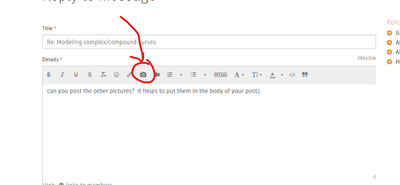

laughingcreek
can you post the other pictures?  it helps to put them in the body of your post
is the .obj a quad mesh or triangulated?
