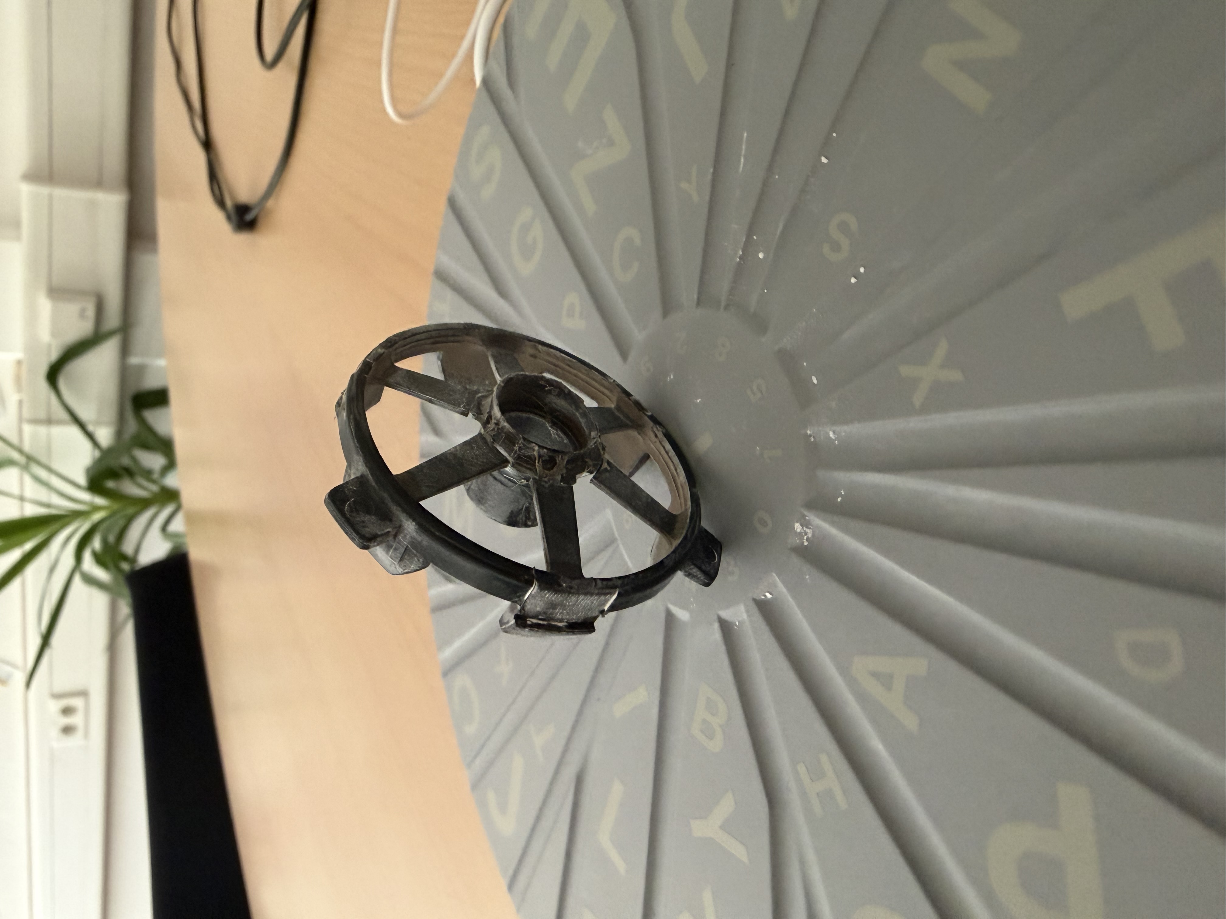

Do you have any photos to accompany this scan?
Message 5 of 11
bolji_zivot92
Sure. This is actually anchor between an engine fan and fan.
