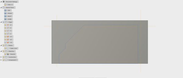

I am trying to create a vacuum forming mold for a part. I can do it simply by making a sketch of the outline of the part and then doing an extrude of the sketch and then a subtract of the two bodies.
However, I want to do it in a more automated fashion. I can use Fluid Volume and then Subtract to create a negative but that really only works for injection molding.
I could also do extrudes for each of the faces underneath (rather time consuming) and then combine them into one body.
Any other suggestions on how to do this in a more automated fashion?

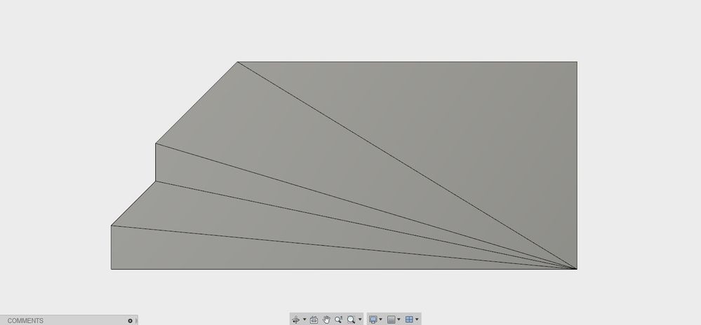

Could you please attach a picture of the final result you're looking for?
Regards
Saeed Hamza
thank you for the reply, this is the right side view of the vacuum forming mold. To make this vacuum forming mold, I had the initial part (solid body), I created a 2D sketch of the profile (I had to adjust to make sure I got the internal cavities below the part), did an extrude of that 2d sketch, and then subtracted the part from the extrude. That approach works fine but I am looking for something more automated and precise. For an injection molding mold, i could just do a "fluid volume", create a negative of the part, and do a split body. But that approach will not work for vacuum forming.
this thread covers various techniques to create a vacuum casting mold (the surf board video was particularly good) but I don't have any history in my model. It is based off a 3d scan.
 the mouse example does not work completely for the model I have
