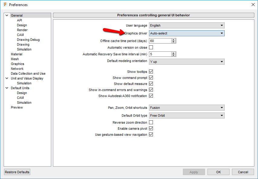

While working on a model dual screen windows desktop, I'll occasionally get a strange bug. The secondary screen (which is blank or contains a webpage or reference image) will turn green for a few seconds. Then both screens will flash black or white. After that, everything returns to normal, except for Fusion. The contents of the model will disappear. The program makes it seem as if I can look around or zoom into a single component, but nothing except white screen.
Fortunately, a quick restart of the application fixes this issue.

That isn't too bad actually. It may be insufficient to run two 4k monitors, or not. Let's try some things.
You can turn off the graphics effects, using the toggle checkbox in Graphics Diagnostic, for a while See if that helps.
It's not clear how old your drivers are for the NVIDIA. If they are more than a year old, you might want to check on the NVIDIA site for new drivers.
Another thing, only after you try the above steps, you can try is forcing Fusion to use DX9 drivers. This setting is in Preferences, which is in the menu under your name, upper right corner.
Please let us know how it goes!

Just to be clear, can you tell me the steps you have already taken? If you can still reproduce it, we need to start eliminating variables.
Did you update video drivers?
Did you try DX9 in Fusion preferences?
What kind of bolt file did you insert? SAT, IGES, or STEP?
Thanks, and I apologize it's not more obvious and easy to fix.

I updated my drivers to the latest version. I did not have DX9 set up at
the time (I now do). I was importing a STEP file from MMC.
