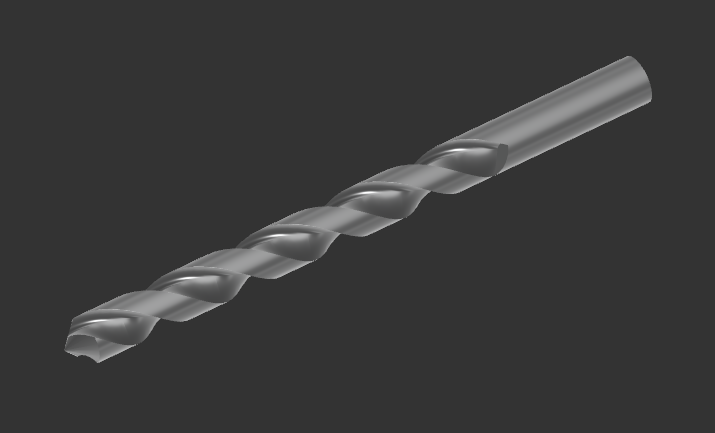

You may want to prove a bit more detail as to what the problem is.
Are you having a problem creating the 3D model, or the technical drawing based on the 3D model ?
TrippyLighting
So I've made an attempt at modeling this according to the PDF you provided and I've come close, but I don't think it 100% reflects the way it is supposed to look like and have asked a question in respect to that in another thread.
Due to the serious limitations of the coil tool this is not trivial to do in Fusion 360. I might make a screencast later.
