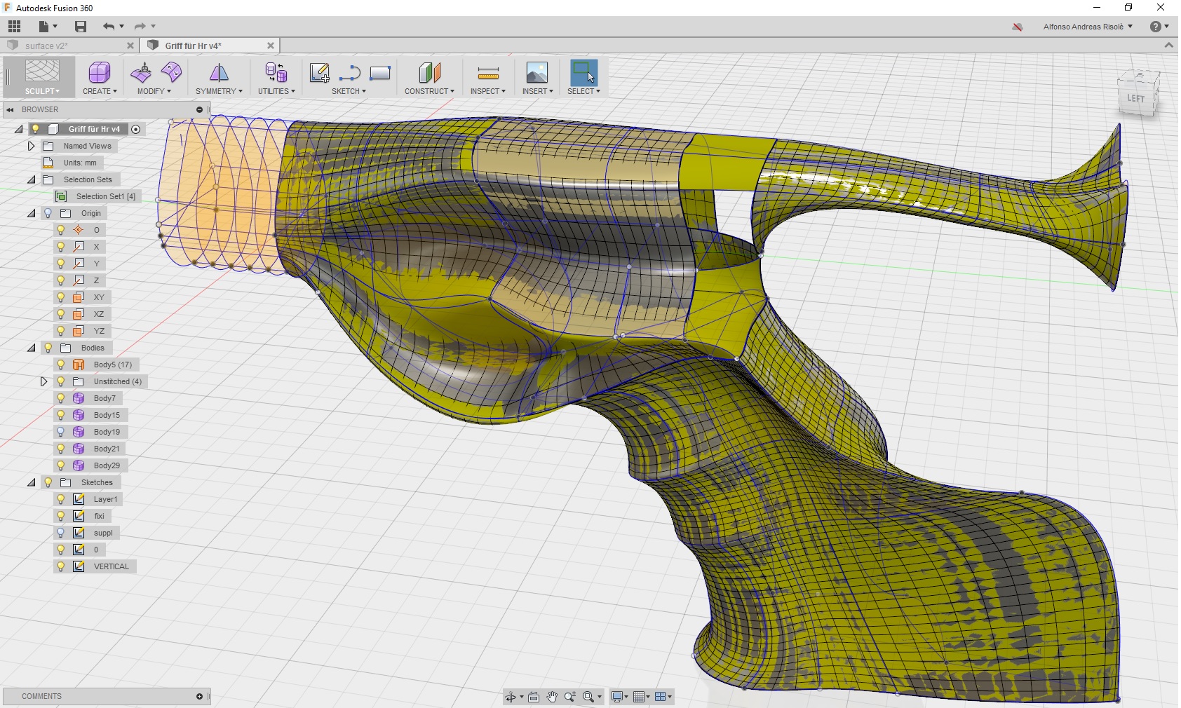

I am an Acad hobby user looking to become perfect continuity on lofted surfaces created from spline constructions, my preferred creation method.
The forms are organic combined with mechanical parts.
I have give it a try in Inventor but Fusion definitively convinced me better. Less complicated and the orientation between planes is  more userfriendly as in inventor for me.
In Acad i use to construct things taking orientation direct from the splines that i form related to the positioning that i do in the 3 d environement. Orientating i do by typing or activating the snap commands  that i need, in free orbit cam.
At the moment i am learning and starting take confidence with fusion.
I have try to import as igs step and sat, it seams to not import 2d at all.
I am here to ask for 2 things, first of all i am tryng to import splines from acad.dwg/step/igs to prevent that i must construct all again in fusion.
The first question is, what filetype have i to import in fusion to have also the splines if it is possible? (I need them to reconstruct it by using T splines). Or what method do you suggest if i already have the lofted surfaces from acad.
I was thinking to loft it in acad even if i not have perfect continuity, cut the surfaces following the splines, after cut it take the edges to reconstruct them with same shape and intersection points.
My other question is, how to import sketches or creations made as 2d in acad (mechanical) to use them as reference in the sketch that i need to position at his place and need to be in relation to the loft guides that i wanna create?
First pic is an older grip, stitched to become it solid.
The other one is the actual one i am making, taller, smaller, no socket and adapted to another trigger mechanism.
Any kind of suggestions are welcome.

Intersect mesh add in is "frankensteinware", doesnt work correctly, he hates overall imported mesh. From your file coming mesh sometime he has appreciate Smiley Tongue he just gave failure, mine he crash fusion constantly.
Here some other pics of an issue that i try to bring away since days and it also dont works.
Thats where i am at trying become better results.
I am going out from original dwg even if splines are corrupted. Seams to be the only sensefull way to avoid power problems.
Near mouse you can see how right side is perfect and left side has kinda deformation on same point. Nearly impossible to fix this. Is the first union that has a nearly acceptable shape, if only this deformation would not be Smiley Frustrated
Use make uniform function is very very limited. Even if on the top i use symmetry and try to adjust edges/int.lines to connect properly and with same quads ammounts, after i do merge edge weld vertices try adjust the rest (before or later), there are always twists.
Simmetry gets lost  elsewhere and i am never in the parameters of sketches.
I started combat with other side today
I go on with Ffrom to see how far i come, i believe that this is the only way without alternatives if i dont wanna remake original splines in fusion itself.
Go out from meshes or something else that cant be imported without corruption is only waste of time in computing and crashes that made my stomach become a poison industry.
2 Months combatting with mesh and no result, i would say thats it.
The deformations on top of freeform body and behold them simmetry where it should, are my actual problems. If i will be able to adjust top side the rest will be possible to.
You think this little deformation can be removed in fform and made simmetryc? i have try for days make a good union, but was not able to make it perfect without issues like this of zebra and "no edge" pic.
