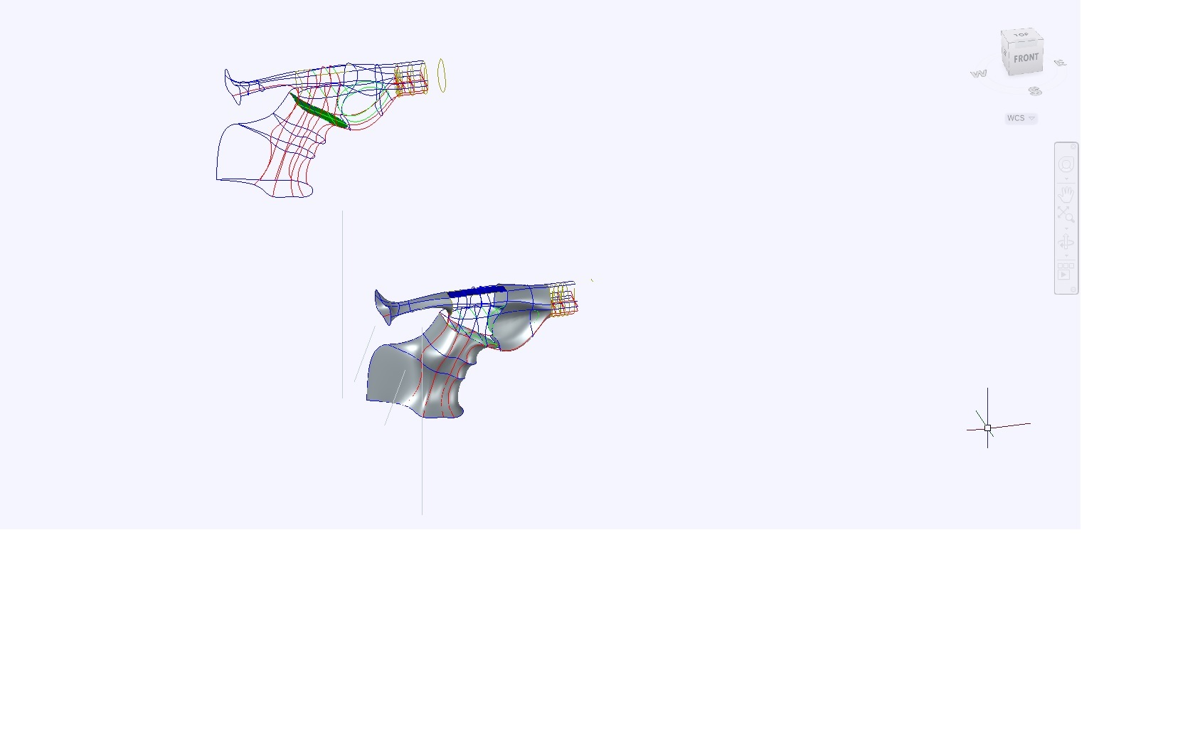

thats what i mean.... i cant move nothing and when i start to put splines and wanna move it i have no way to snap or input where it must capture (end, intersection etc etc)
How to put a spline where i want? in sketch nothing works, no snap even if snap is activated. I dunno ho find endpoints or midpoints... intersections, and my 3 d on the side i cant move it neither.
How say to splines where to intersect or start? how to move parts or 3ds on the spline sketch 😞
I think be on the good way, but if i dont find how orientate the functions i am blocked.
