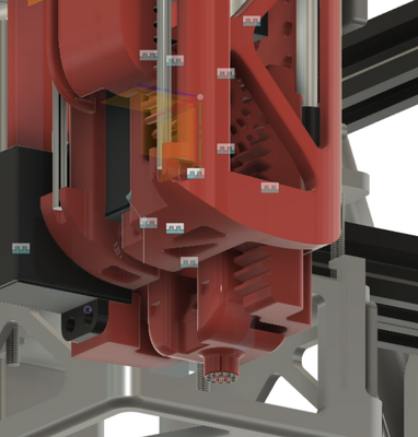

I am putting the part in direct edit mode to update a link component but when I reverse that and start recording the timeline again all the joints are knackered, its almost s though it has exploded the part.

Jointed Part Working (sliding and rotary joints linked):1
Jointed Part Working: 2
The total mess resulting from putting in edit mode and then back in timeline mode (almost everything has randomly moved apart from the grounded component):
