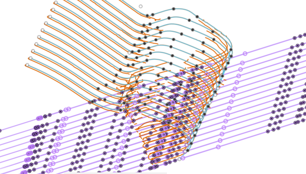

I am trying to do a loft in the surface enviroment from a large amount of mesh section sketches, which don't all have the same amount of points on the spline that makes that sketch. Is there a way for the loft tool to "nicely" transistion from having the point on one sketch to not on the next? I am ending up with lots of little ridges, which I think are causing it to fail when I try to thicken the body.
Ridges in question.
Part file should be attached to this post.

you might can tame the loft by adding rails, which will define the point to point locations, but I don't think the general approach of lofting this area is an approach that is going to work well for this part.

How would you approach it? I had tried modeling it regularly before, but when it got to the strange "wiggles" in the center, I couldn't get it to match.

@ethanA7E82 - a few recommendations:
First, you have way too many profiles in this loft.  You can probably get very close to this mesh with 1/8 to even 1/10 of the number of profiles.  That loft has 57 profiles in it.  You can hardly even rotate the view with the time Fusion spends just painting the labels:
second, each profile is made of of separate curves.  This is what really causes the point mapping to get confused.
If you go back and re-fit those splines (yes, I know that is a lot of work), you can come out with a much better loft result.  Re-fitting those using Fit Curve to Mesh Section is really just two clicks - start and end point with the type set to spline.  I noticed that some of the mesh sections are not complete, and then it's a bit more work to get the spline, but it is still not that many points.  In this example, I took just one section, and replaced about 20 profiles with 4, each with only one spline in it,  This completely gets rid of the wrinkles in the surface:
because each profile has only one curve, so there are no midpoints to map.  And even though I was not very careful, the result matches the mesh pretty well.  You could do much better pretty easily.
so the moral of the story is:  lots fewer profiles, and one curve per profile.

Thanks Jeff, That made a big difference. I figured that with more profiles I would get better detail, but with about 15 I am getting more than enough. Thanks for looking into it.
