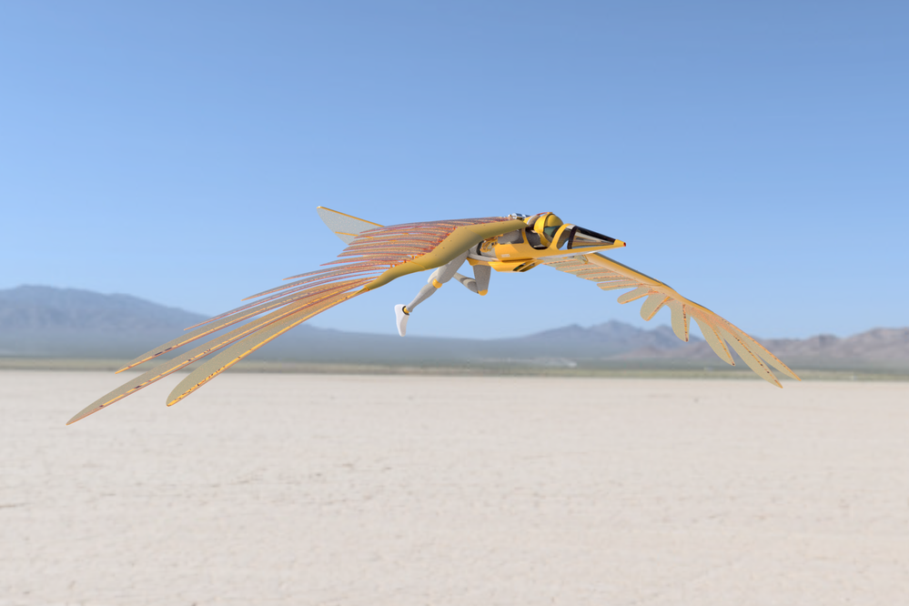

For a long time I was able to click and drag various parts of my Falcon 12b model into new positions. For instance, I could click on the mannequin's foot and drag the whole leg into new a position, fold it, or straighten it, etc. Then, somewhere along the line this was no longer possible. I would open a file, drag parts of it around and then, after a few moves, it would no longer move. It became immobilized.
One time I saw a brief notification appear that I thought contained the word "immobilized" but it quickly disappeared before I could read it.
Anybody know what's happening? Is there any way to unfreeze the model once this happens?
