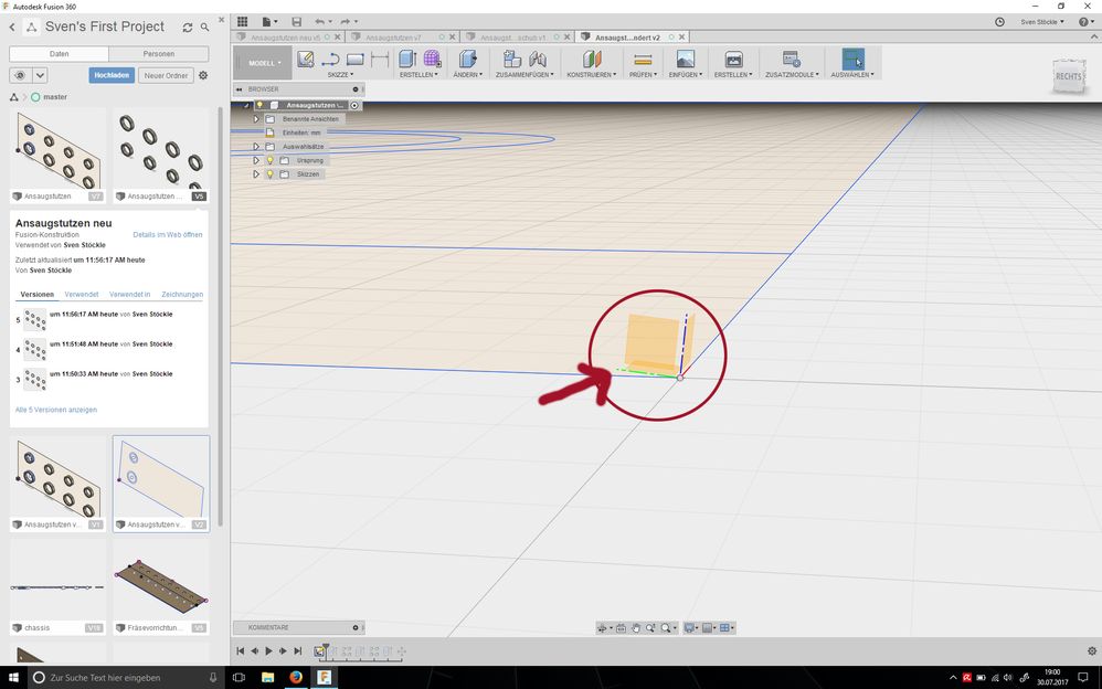

Dear all,
could someone explain please how I can set the angle of the origin so that it is equal to the sketch itselft?

The angle between the green and blue line. In the blue line is my sketch located

please see the picture below. As you can see the green and the blue axes doesn´t align with the sketch. I think this will produce mistakes in the routing process isen´t it?ursprung.jpg

ok, you´ll find two f3d-files in the attachement, the first file shows the wrong angle of the zyx coordinate => Ansaugstutzen v8
in the second file (=>Ansaugstutzen neu) I did a new sketch so that the sketch align with the zyx coordinate. But as before I got mistakes in the routing process, for example see plaeseIMG_8227.JPG the picture in the attachement.

It is not necessary to change the origin or change the sketch plane in order to machine these parts.  You do need to use the correct settings in your setup.  I'll make a video of the changes needed in a little while.

Hi etfrench,
thank you so much! I really can imagine that it would be more efficient to create two new toolpaths. But with your video I learn a lot more! Smiley Very Happy
What I didn´t understand is that the simulation of the milling process looks all the time good. No mistakes wasn´t shown. Do you know why?

At 6:53 in the screencast you can see the tool is cutting on the wrong side of the selected contour.  I'm not sure why the red arrows were pointing the same direction on the two end parts as on the others.  The simulation showed they weren't correct.
The CAM module is really good compared to others, but it does take time to learn how to get the best tool paths and what the limits of your machine are.  I have quite a few broken tool bits to show for my learning curve.  Smiley Happy
