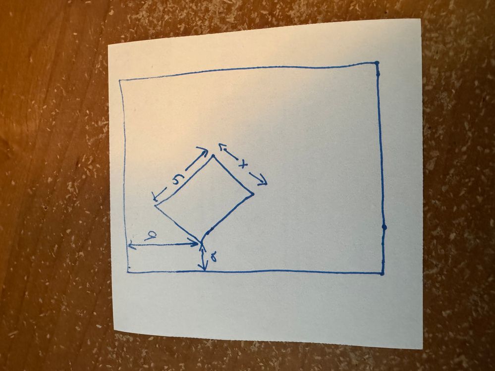

I'm trying to create a rectangle inside another rectangle (see image). The outer rectangle is aligned with the axes so that's easy to make. The inner rectangle is skewed and I'm not sure how to do that.
I also want to constrain the Northwest corner of the inner rectangle to specific distances from the North and West sides of the outer rectangle. (I don't know what angle the inner rectangle is rotated, but I can measure the distance to the edges of the outer rectangle.)
I think this should be fairly straightforward if I just knew the magic incantation. Please advise.IMG_2566.jpg

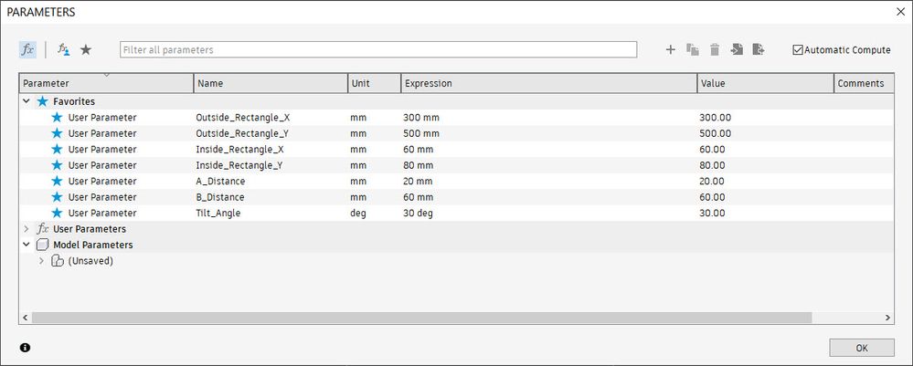

Here is a Parametric layout of the sketch you desire.  I also added a Parametric Angle just in case you want to use it.  Modify the Parameter table to suit.  I used millimeters but the same would be true for other units.  Model is attached.
If this answers your question, please select the "Accept Solution" icon on my post.

Thank you for your input. I have no doubt this will work, but I have no idea what you've done. I haven't done parametric modeling in Fusion before (or any CAD software for that matter). Please excuse my ignorance.
