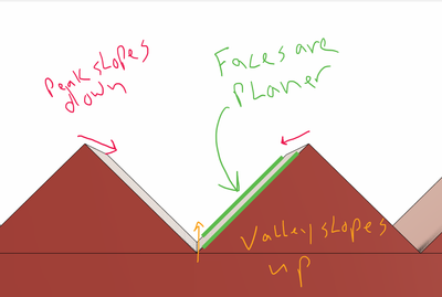

laughingcreek
if you want the teeth from one disc to be able to fully mesh with a second one when placed together, then you have to insure that the peak of the teeth are slopping down, the valley is sloping up, and the faces of the teeth are planer and not twisted/warped.
attached is an example.
