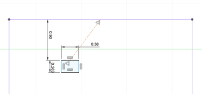

Seems like this should be quite easy but it has me stumped!  I dimension the rectangle 0.8 from the line, then want to centre it along the line. Tried using midpoint but it says "Failed to resolve. Please try revising dimensions or constraints".
I want to centre even if I change the rectangle size, so thought constraints are a good way to go rather than calculating the dimension...
Where am I going wrong?

877cms
Not sure if I explained what I want clearly so apologies!
I want to move the rectangle like the attached below, so it stay 0.9m away from the line but is exactly centred along the top line in effect.

Message 6 of 10
877cms
Sure, this is an example sketch of exactly what I'm trying to do.
Just want to centre the rectangle along the 200mm line, while keeping the 50mm distance from it.

Message 8 of 10
877cms
Thank you @TheCADWhisperer I misunderstood @davebYYPCU solution, I was letting go of 'Shift' and not selecting the second midpoint. Thanks for pointing me back to that 🙂
It works!
