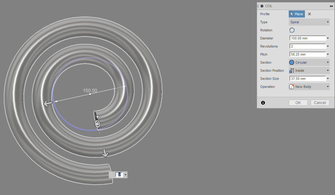

Just in case you hadden't noticed coil has an option to make a Spiral.
After creating the solid spiral you can extract the seam using project in a sketch.

yes, i noticed now... works if you just want a spiral without the need to move it aroud (rotate for exemple) or edit the pitch... since once you deleted the body just to have the projected sketch, editing brings back the original position and even the body as well.
