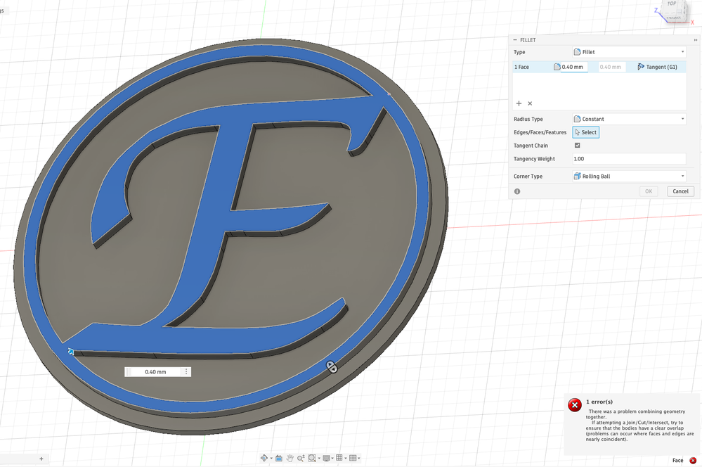

This is a problem for me in general quite often. If I have a more complex shape, typically with points, I can't use fillet or chamfer on it regardless of the settings I try for them. Now I need to round the edges of a letter with a circle and again at 0.4mm I encounter an error ( the circle has a diameter of 155m and the extrude of the shape is 4mm. ). How can I make rounded edges even for such a shape?

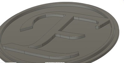

I would model the text.
Message 5 of 10
bpetersen9BTH4
Fusion highlights the area that is giving the alarm in red.
in this case you have a small triangle sticking out the top right side.
zoom in and youll see a red line on 1 side of the extra triangle. delete this triangle and youll be fine.

bpetersen9BTH4
here ya go
Message 8 of 10
SaeedHamza
The issue is simply this small sharp corner here, remove it by selecting both sides of the sharp corner then delete them, that would create a "Delete Face" feature in the timeline, then fillet using the top face will work just fine.
Find attached the .f3d file with the above fix applied.
