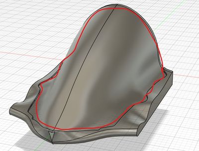

hughesey2192
I have created a body from a mesh scan. Specifically a motorcycle screen profile.
Body is hollow in the middle, and the intent is to 3D print a mould, and create a vacuum to form an acrylic screen to match the mould.
So, I need the mould to be covered in holes to draw air through (via a vacuum source of some description).
Short of manually adding individual holes, is there a way that I can cover the moulding area (circled red in attached image) in holes through to the hollow chamber? Ideally holes would be perpendicular to to the surface.
F3D attached. Workflow is pretty untidy - Its one of the first models I've done from a 3d scan, so there was a lot of trail and error going on. Plan was to start fresh and do it tidily once I got to the end state.

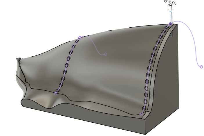

TheCADWhisperer
Examine the Attached.
I only did two (half) rows to demonstrate the technique.
If you have trouble figuring it out - post back with questions.
Edit: I just figured out a way to create paths more easily.

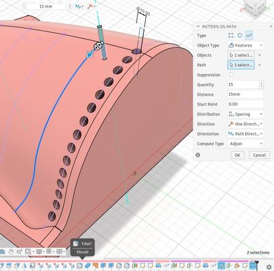

hughesey2192
Ah I hadn't thought to do a revolve! I usually extrude holes, which might be a bad habbit.
Good to know I was geting close with the Isoparametric curve.
I'm having trouble making the pattern follow the path. I create the first hole in the same manner as the second row you've done with axis perpindicular to face at a point. The pattern will work when orientation is 'identical', however fails when i switch orientation to 'path direction'. I can alter the patterns on paths that you've created, but can't seem to get it to work using the Isoparametric curve.

TheCADWhisperer
@hughesey2192
Attach file here.
Set you Compute Type to Identical rather than Adjust.
Message 5 of 8
hughesey2192
See attached. Are the paths maybe not intersecting correctly?
Message 6 of 8
hughesey2192
I tried all three compute types. Weirdly if i select the path below the the one I'm trying to pattern along, it works. So I think it's an intersecting issue. I'll try different methods of projecting the path. Thanks for your help :).
Message 7 of 8
hughesey2192
Figured it out. I was using 'Project' not 'Intersect' to pick up the sketch profile on each plane/row.
The Isoparametric Curve was good for getting the lines onto the surface, but the pattern did't seem to want to follow those paths, only the 'intersect' paths on individual planes.
