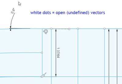

This element has incorrect geometry. Look at the transition between the flat area and the arc - they're not in the same place. Sheet metal modeling requires precision and adherence to many rules, which were violated here.

1. As @kacper.suchomski  points out, the problem lies in the lack of tangentiality in Sketch 1
2.
günther
