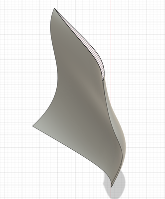

Hi everbody,
I'm trying to model the following and can't get any further. NiceNico_0-1756679454998.png
It is the blade of a Whopper Plopper lure. In Rhino I would loft it using several 3D curves, but in F360 I just can't get any further. Thats my progress so far:
Any advice would be appreciated.
Thanks everybody for their help.
File is attached.
Best,
Nico

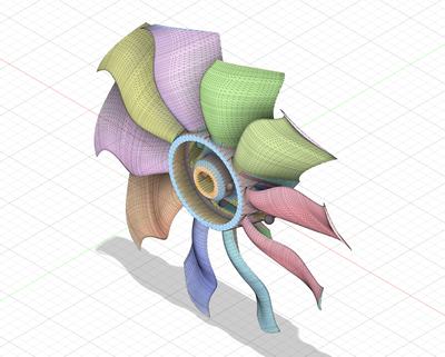

My Project is a Ducted Fan that rotates at 20,000rpm. At those speeds the airfoil
shape of the blade is critical. The method that I use is this.
I start by creating a Front View Sketch of what the 3D curve looks like. This is the
Leading Edge of my fan blade.
Then I do the same with a Side View.
I do the same for the Trailing Edge.
I then change to Surface Mode and extrude these lines into Surfaces.
I then use the Thicken command and turn these surfaces into Bodies.
From here I do a Combine Intersect operation that creates the portion
of these bodies that intersect with each other.
Now I have two 3D shapes that I can use as Rails for a Loft.
The end result is a Blade with complex curves.
As I said, very crude - but it works.
The trick is to make the thickness of the surfaces thick enough to get
a usable rail. The Rail is the edge of the Body you just created. Lining
up the profiles to Loft is a little bit of a fiddle but you get it by zooming
right up close then click and drag if necessary.
Cheers
Andrew

Nico-thought i'd take a stab at this over my morning coffee.  attached is a possible approach you could try.  let me know if you have questions-
Message 6 of 20
NiceNico
Hi and thank you both @Drewpan  and @laughingcreek,
I thought modelling this would be similar to what I would do in Rhino- similar to what @Drewpan  did.
Somehow I had the impression that there is probably another way in Fusion and that's why I wanted to post the whole thing.
Thank you @laughingcreek for your interesting solution suggestion, which I would definitely never have thought of on my own.
I will try to remodel both for practice.
Thank you again and best regards,
Nico

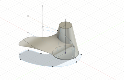

Hi again @laughingcreek,
finally I had the time to try your approach and at least I got my head wrapped around - I think.
But I fail in the execution. If could have a look and give me a hint I would really appreciate - I already learnt a lot from your file ( about loft:))
Thanks and have a nice weekend,
Best,
Nico
Message 13 of 20
davebYYPCU
Couple of things,
Too many spline points in the sketches, and the height of the two splines in each sketch are "öut of level" on your file, compared to Alex's file.
He has a spline point at top dead centre of both splines, that are exactly Horizontal to a projected point in sketch 3. (Advanced level working)
Allows for the selection of a bottom, front and back body edges for the Patch command.  (Advanced level working)
You do not have a point at top dead centre in either sketch, and that makes the Extrude Cut leave a big curved cross over.
In other words, the front sketch in my pic is too high, and must line up with the side sketch height.
Might help...
